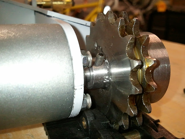

new pictures
ari
Stick is now ready to get some paint
ari
Comments?
To that Point you have done a great work ,i think when you ar done it will be a more as beautiful conversion . Herz
Spiertz Transporte
It looks very nice , good job well done
