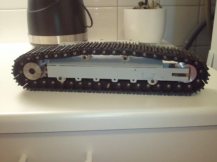

Hello,
Small update. Undercarriage is now assembled. I also get parts for the boom and uppercarriage.
And picture
LR 634
Hello,
the Undercarriage looks great. top
ari
Small update. One track is assembled to see how it fits
http://picasaweb.google.com/lh/photo/AP4...feat=directlink
Kawoom
I can`t see the picture unglücklich
Burningboard tranlates the 8 o into geschockt and so the URL dosnt work .
ari
New try, for some reason, link to my picasa does not work.
ari
New pictures
Kawoom
Looks great! I like it großes Grinsen
